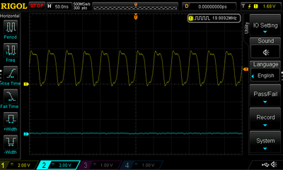

Best answer by AScha.3
From my tests :
20 MHz can get from H743 , at 480MHz , -O2, : 25ns hi or lo time ;
compared to cpu with "better" = direct access to port/bus : H563 , at 250MHz :
 4ns pin access, 16ns with while-loop : 82MHz output by pin toggling - not bad , i would say...
see:
https://community.st.com/t5/stm32-mcus-products/which-is-best-stm32-mcu-for-fast-driving-of-gpio/m-p/632729#M233727

Not really a great test, way the bus is constructed apt to be slow.
Use a TIM, they have an actual mode for this..
Perhaps use an address bit of an FMC bus? And use M2M mode DMA

From my tests :
see:

As @Tesla DeLorean said above, in 'H7, GPIO access time from processor is dominated by traversal through the many buses and their interfaces
