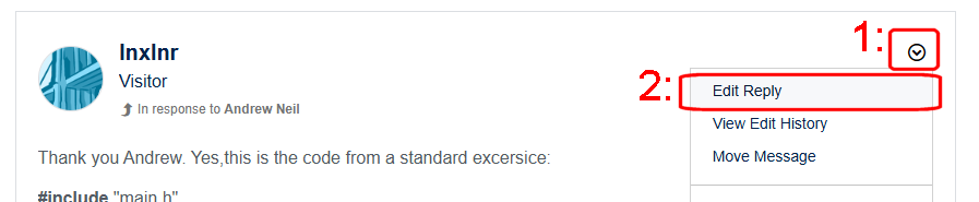

The Code inserted properly as Andrew said.
You didn't follow the tips on how to post source code.
See also: How to insert source code.
Please edit your post:
