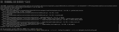

Hi all,
I'm running into an issue when trying to deploy a model from to my STM32N6 board.
I am following this guide: https://github.com/STMicroelectronics/stm32ai-modelzoo-services/blob/main/object_detection/deployment/README_STM32N6.md
running script:
python stm32ai_main.py --config-path ./config_file_examples/ --config-name deployment_n6_yolov8_config.yaml
But ending up with following error:
deployment yaml:

Any ideas what I am doing wrong ?

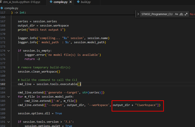

Hi Team,
I wanted to share that I’ve successfully resolved the issue we were encountering. The problem stemmed from a line in compile.py which I needed to modify.
The original command failed to execute correctly when the --output and --workspace paths were the same:
C:\ST\STEdgeAI\2.1\Utilities\windows\stedgeai.exe generate --target stm32n6 -m ../../../stm32ai-modelzoo/object_detection/ssd_mobilenet_v2_fpnlite/ST_pretrainedmodel_public_dataset/coco_2017_person/ssd_mobilenet_v2_fpnlite_035_192/ssd_mobilenet_v2_fpnlite_035_192_int8.tflite --output C:\STM-Coding\stm32ai-modelzoo-services\object_detection\src\experiments_outputs\2025_05_13_21_59_34 --workspace C:\STM-Coding\stm32ai-modelzoo-services\object_detection\src\experiments_outputs\2025_05_13_21_59_34 --st-neural-art default@../../application_code/object_detection/STM32N6/Model/user_neuralart.json --input-data-type uint8 --inputs-ch-position chlast

Hi Team,
