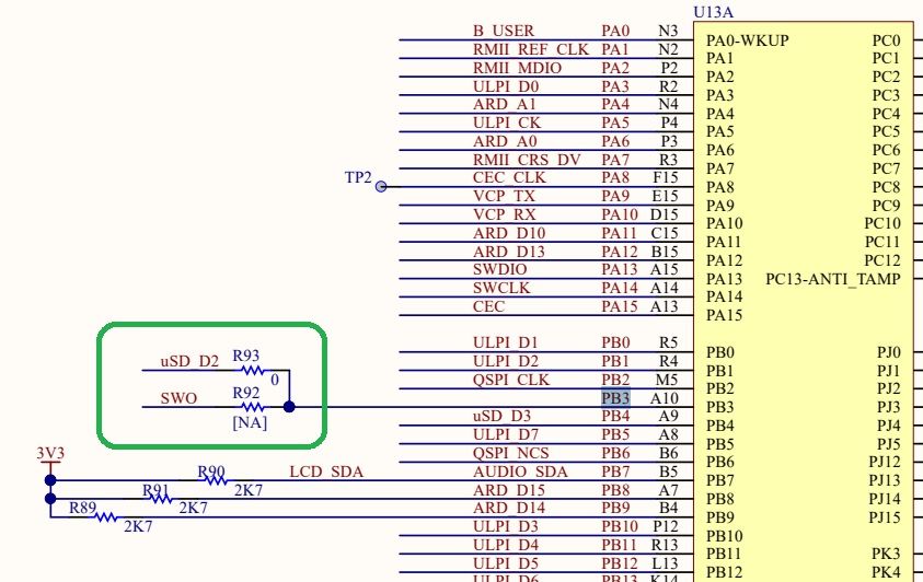

Make sure there's not a Solder Bridge you need to make for PB3/SWO pin

Which solder bridge do you refer i do not see any comment about a solder bridge for PB3 and SWO in the UM2033
User manual for the Discovery kit with STM32F769NI MCU i can not find by search or by reading it anything about SWO?

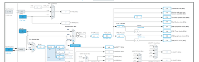

Currently the clocks are set like in the screen from Touchgfx. What do you propose to change?

The do not have anything else about SWO and they have only 2 pins for the clk and the swdio in the pin explanation. In the ioc at the pin PB3 you can see the function to select and as i said it is automatically set if you select Trach asynchronous SW.
Is it possible that it does not work?
I mean check the schematic, some of the DISCO boards have solder bridges in the signal path, I'm saying make sure your board (model/revision) does not
https://www.st.com/en/evaluation-tools/32f769idiscovery.html
https://www.st.com/en/evaluation-tools/32f769idiscovery.html#cad-resources
https://www.st.com/resource/en/schematic_pack/mb1225-f769i-b02_schematic.pdf
Yours has a Resistor and SB21, the default path is too the MicroSD socket SDIO/SDMMC2, needs to be switched over so there is a conductive path for the signal to get into the ST-LINK T_SWO pin
You mean to desolder R92 if you mean this then it is probably impossible in the process I will probably damage the PCB. I will use uart instead if this is the case
