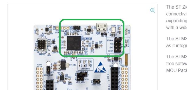

Review the picture of the board, the 1x1 cm chip at the North End of the board is an ST-LINK/V3, this provides for primary debugging and a VCP that connects to one of the H723's USART's
https://www.st.com/en/evaluation-tools/nucleo-h723zg.html

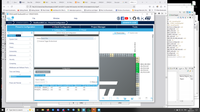

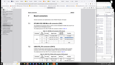

Thank you for the help. I was not 100% sure.  What I don't understand is the debug serial wires  via MUX is on PA13 & PA14
CN1 is connected to PB14...
SO the IDE software does not see the ST-Link:
Sco
---- PB14 is the pin of STLINK MCU, means through USB connector(CN1), the PC talk to STLINK.

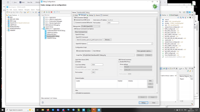

Please see the problem I have.  To debug via USB the IDE must point the serial line to PB 13 & PB 14 and NOT NOT NOT PA 13 & PA 14.
The IDE software connects the debugger to PA 14 & PA 13 AND NOT TO PB 13 & 14.
So how do I get the IDE to connect the debugger to PB 13 & PB 14 and not PA 13 & PA 14?

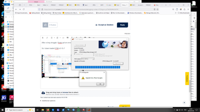

After a long struggle I finally got an error message that states the boards firmware must be upgraded.
So I down loaded STM v3-15-7 run it.
The software picked up the board via USB (brand new cable)  started the upgrade and now I get this error:
I tried about 10 times and it keeps on crashing at this point
