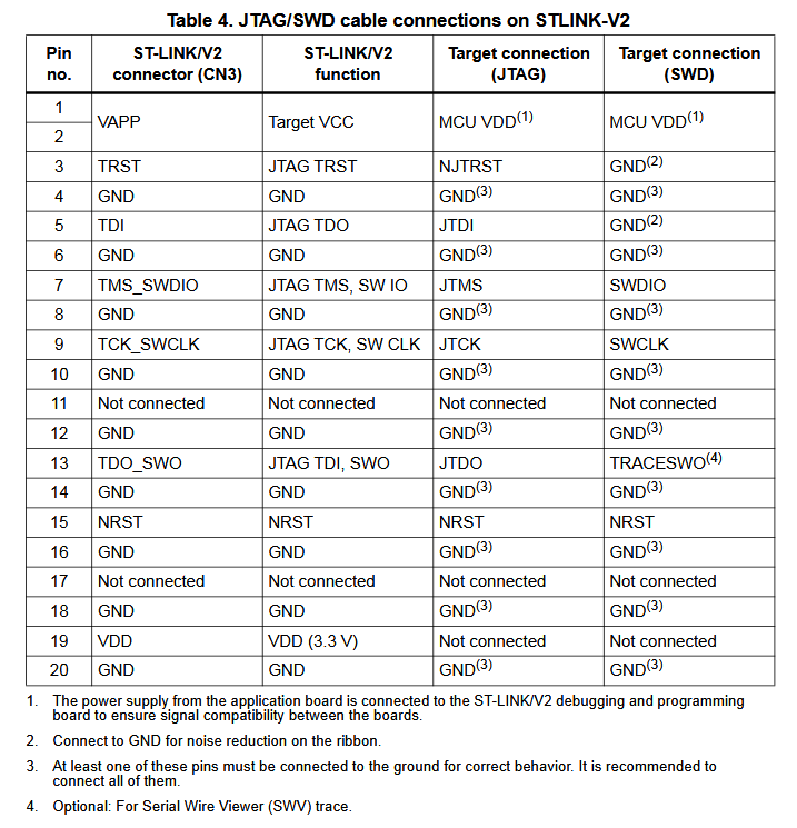

* In the B2025 16 debugger, the target voltage (~3.3 V) is measured on Pin 1 of the 20-pin connector.
* In the A2017 10 debugger, the target voltage (~3.3 V) is measured on Pin 19 of the 20-pin connector.

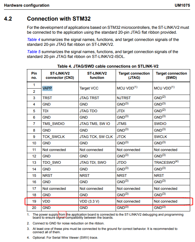

Please check the ST-Link user's manual section 4.2:
ST-Link UM
There is a VDD 3.3V on pin 19, but please don't use it, it is not designed for power supply.

So your target's voltage VDD (maybe 3v3 or something below) must be connected to pin  1 or 2 of ST-Link's 20 pin connector CN3, This is VAPP: the voltage of your application, connected to ST-Link. It is an input pin for ST-Link.
It's level while unconnected has no meaning on ST-Link side.
Ignore pin 19. This is neither  suitable to measure the target's voltage nor to supply anything. It is simply irrelevant.

The User Manual could be a lot clearer about this:
It does, indeed, show that it should not be connected to the Target - but gives no indication as to why, nor what purpose this pin does serve.
Also, the description of VAPP could be a lot clearer that it's an input to the ST-Link from the Target.

So always (!) you have to connect pin 1 (and/or 2) to target VDD. (st-link  check here VDD of target = ok ?)
+ usually have target powered by external supply.
And -no guarantee-  pin 19 to get some 100mA max. for target supply.  (only for small target, < 100mA !)
