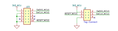

I have been using PE micro Multilink FX for several years, but its Linux support is terrible. Is there a ST (or another) alternative with this functionality compatible with stm32CubeIDE? I just need to supply power (up to 100 mA at 3.3V) to my board for debugging. I don't need high tracing performance or anything like that.
Thanks in advance,
Gaston

No. I need supply power 3.3V through 10-pin connector along SWDIO, SWCLK and RESET signals.

Power is not supplied in the standard 10-pin ARM debug header. All ST programmers adhere to the standard and do not supply power on a 10-pin connector.
https://documentation-service.arm.com/static/5fce6c49e167456a35b36af1
It doesn't look like the 10-pin header on the PE micro Multilink FX is any different. What pinout are you using that you want to duplicate functionality?
The st-link v2 has a 20-pin connector with 3.3V power supplied on pin 19. That's the closest you'll get.

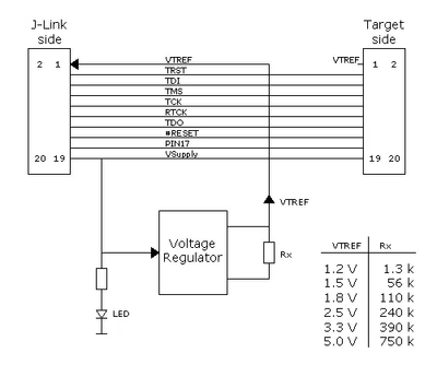

Segger J-Link probes are very good and can supply 5 volts.
It appears they have an adapter for other voltages: https://www.segger.com/products/debug-probes/j-link/accessories/adapters/supply-adapter/.
https://kb.segger.com/20-pin_J-Link_Connector
"Pin 19 (5V-Target supply) of the connector can be used to supply power to the target hardware. Supply voltage is 5V, max. current is 300mA. The output current is monitored and protected against overload and short-circuit. For more information about how to enable/disable the power supply, please refer to Target power supply "
Interesting. I didn't know about this adapter.
I believe this offers the possibility of removing VCC from the target board connector (maybe to simplify the PCB layout?). This way, it ‘tricks’ the debug probe for monitoring its own voltage (pin19) instead of monitoring the target MCU voltage. With all this, it does not end up providing power to the target MCU.
