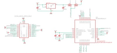

Hello community,
I have thiss board, the first one  I'm designing from scratch on stm32 platform. I am able to connect and program just fine to some of the MCUs, but for the vast majority, the chip somehow gets fried before I can program it: I can't detect the MCU at all with cube programmer.
Here is the relevant part of the schematic I'm using, is there anything I should add? This board connects to a programming board which is in turn connected to the ST link.
MCU is STM32G0B1

Make sure grounds between programmer and target are safely connected, before connecting any other signal, including power.

what @waclawek.jan  said, also check if youre applying more than 3.3 / 5 v  to the gpios.
Most times this happened to me was because of isulated power supply and then i happily connected the Oscilloscope ground or my laptop ground *trough stlink

We have a power switch on programming board. We make sure it's switched off before plugging the board. That should be enough? The STlink however is still powered then, but I believe it's OK since it doesn't provide any power?
What do you mean by "insulated power supply"? Like a battery or something not connected to general ground?
Also I don't think I go anywhere above 3.3V as I have an LDO before supply, and it's not fried. I have some doubts howwever on it's reliability...It could be that it's not good quality (I had to make tradeoffs regarding size) and produces some voltage spikes.

What's the STM32 package?
Are you 100% sure about the soldering quality, also of the LDO?
PB15 directly connected to GND looks dangerous, what's that pin ? Maybe try to get 1k between pin and GND.
i meant isolated sorry for the typo.
Just make sure all your GND are connected together, from your stlink(USB laptop) and from your power supply and any oscilloscope probe
