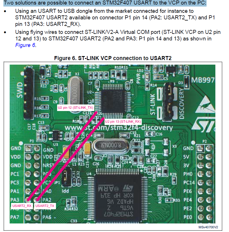

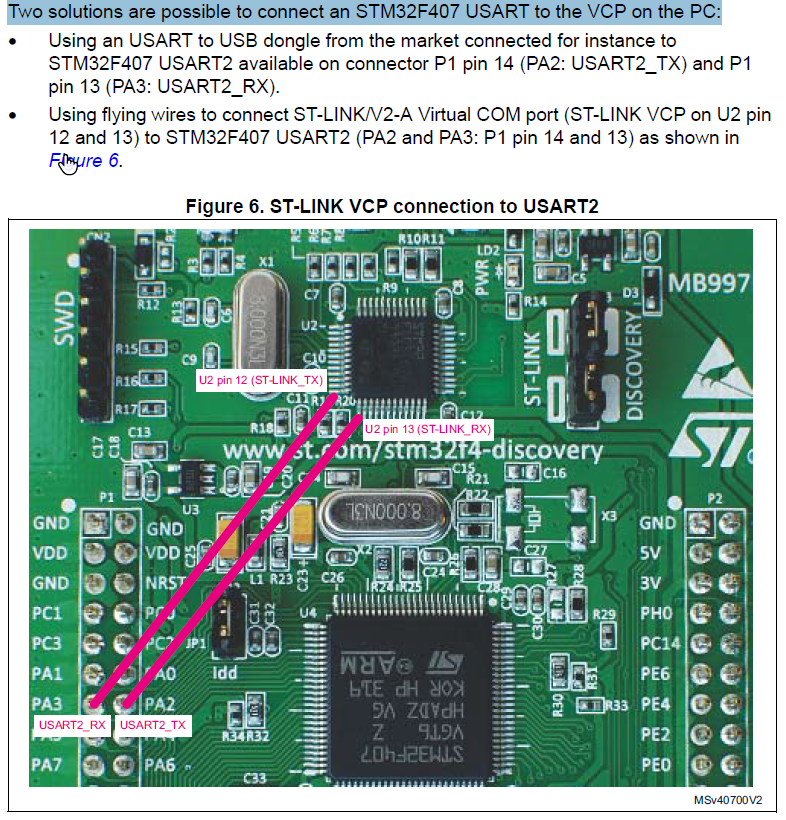

Hi there,
I want to do a printf redirected to a Tera Term using the USART2 on the STM32F407G-Disc1, but it doesn't print while the same code works on the NUCLEO-F401RE. I found this instruction in the user manual UM1472. Does it mean that I have to use two flying wires to connect the U2 pins to the P1 connector pins to make it work ? Thanks for your help

Peter BENSCH
The STM32F407G-DISC1, formerly knows as STM32F4DISCOVERY, still uses an ST-LINK/V2-A that does not yet offer the VCP functionality found in the newer DISCOVERY.
in order to still be able to work with a VCP, you can use the options mentioned in UM1472, section 6.1.3 with the newer STM32F407G-DISC1: either an external USB-UART converter, or the mentioned flying wires.

Please excuse me for not being clear enough: the recent STM32F407G-DISC1 is able to provide VCP if you connect the pins using e.g. flying wires. The solution is only applicable on this newest version, not to the older STM32F4DISCOVERY.
