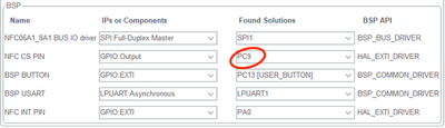

I have confirmed that the issue was due to an incorrect CS pin configuration. The NUCLEO-L476 and NUCLEO-U545 actually have differences in their pin assignments.
Below is the correct configuration, which can be used for NUCLEO-U545 + ST25R3916B (X-NUCLEO-NFC08A1).
