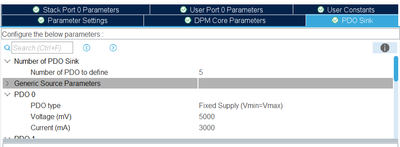

Board:STM32U5A9xx
I set the Number of PDO to define = 5 in the cubeide.
But after generate code, the code in usbpd_pdo_defs.h, macro:PORT0_NB_SINKPDO is still 1U.
I also checked the file usbpd_pdo_defs_u5.ftl in cubeide's location, the macro PORT0_NB_SINKPDO is a value param from cubeide indeed, but it seems not effective. Is a bug?
/* Define   ------------------------------------------------------------------*/
#define PORT0_NB_SOURCEPDO         0U   /* Number of Source PDOs (applicable for port 0)   */
#define PORT0_NB_SINKPDO           1U   /* Number of Sink PDOs (applicable for port 0)     */
#define PORT1_NB_SOURCEPDO         0U   /* Number of Source PDOs (applicable for port 1)   */
#define PORT1_NB_SINKPDO           0U   /* Number of Sink PDOs (applicable for port 1)     */

I am currently investigating your request. For more investigation, could you please provide your Ioc.File.
Thanks.
mahmoud
Jason927
Plus:
CubeIDE Version:1.19.0
MCU Package Version:1.8.0
@Mahmoud Ben Romdhane
ioc file in here
Hello @Jason927 ,
I was able to reproduce your request.
Thank you for bringing this issue to our attention.
An internal Ticket was submitted to the Development Team (Internal Ticket Number: 216304).
I will keep you up to date when the problem is solved.
