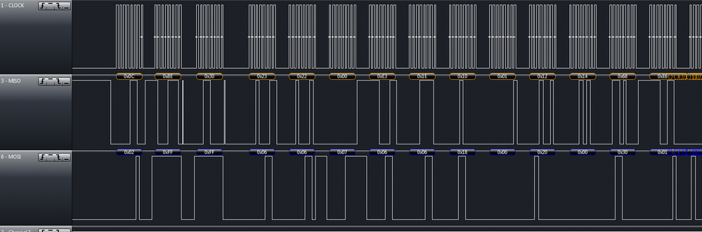

dear all:
            i have received the error codes: 8E....(it is really a long data)from ST95HF,which means ''reception lost without EOF received'',i don not know why,are u guys have the same problem.and this error code occurs only when i use NFC function

Thank you so much for your reply.There are our command code:(We select 15693 protocol in reader mode,we want to read 15693 tag)
1�?00 02 02 02 09
2�?02 ff ff
3�?00 09 04 68 01 01 D1
4�?02 ff ff
5�?00 04 03 26 01 00
6�?00 55
7�?02 ff ff ff
8�?00 02 02 00 00
After we send the 00 02 02 00 00,the ST95HF replys a lot of code back,which more than 50 byte.
And there are some interesting phenomenons we had finded in our process:
1�?if we use 3.3V for VPS_TX,the ST95HF never replys error code
if
we use 5V for VPS_TX,the ST95HF replys error code

You wrote that you want to use the 15693 protocol to read 15693 tag, but your first command selects 14443A protocol.
For 15693 you should send this command:
->  00 02 02 01 1D             (ISO15693, 52Kbps, Wait for SOF, Mod 10%, Single Subcarrier, Append CRC)
Let me know if this is 15693 or 14443A protocol you want to select.

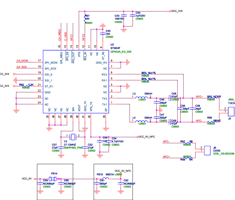

What was the voltage set on the ST95HF board at design (3.3V or 5V)? You cannot change
VPS_TX voltage only, you need to adapt your board when moving from 3.3V to 5V (and vice versa). VPS_TX, VPS_Main, Antenna tunning, ....

Posted on August 26, 2017 at 08:52
Thank you very much for your reply.
We do want to select 15693 protocol to read 15693 tag.At our design,the VPS is used 3.3V for supply voltage,and the VPS_TX is used 5V for supply voltage.But i do not see any suggestions about the VPS ?VPS_TX have to be designed with the same voltage in the ST95HF DataSheet. There is my design schematic diagram below.Looking forward to your more suggestion. 0690X000006081QQAQ.png

2) What I intended to say by '
You cannot change
VPS_TX voltage only', is not that you must have VPS_TX = VPS_Main. But if you design your board with VPS_Main = X.X Volts and VPS_TX = Y.Y Volts, you cannot change those values without adapting the board (antenna tuning, capacitors, ...).

Posted on August 29, 2017 at 02:43
Thank you again for your information. it does help me a lot.
I had follow the antenna design guide and used the calculation tool to design the antenna. Is there any problem
with VPS_Main = 3.3Volts and VPS_TX = 5 Volts,would it do harm to the ST95HF.

Posted on August 29, 2017 at 10:02
There is no problem to use ST95HF
with VPS_Main = 3.3Volts and VPS_TX = 5 Volts. O
ne thing to be aware is that the signal on RX1 and RX2 (between RX1-GND and RX2-GND) does not exceed 8 Volts. With your 1Kohm resistor, this is very sufficient to attenuate the signal.
Your command to select ISO15693 protocol is OK and the ST95HF should answer:
-> 02 00 00
And after that the ST95Hf is ready to send RF commands.
Best regards.
