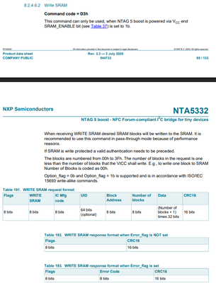

WRITE SRAM (0xD3) request
  • Flags (8)
  • WRITE SRAM (8) = 0xD3
  • Manuf. code (8) = 0x04
  • UID (optional)
  • Block Address (8)
  • Number of Blocks (8) — N-1
  • Data = N × 4 bytes
  • CRC16
Only Option_flag = 0 is supported for D2/D3. Datasheet also says SRAM must be enabled and not protected.

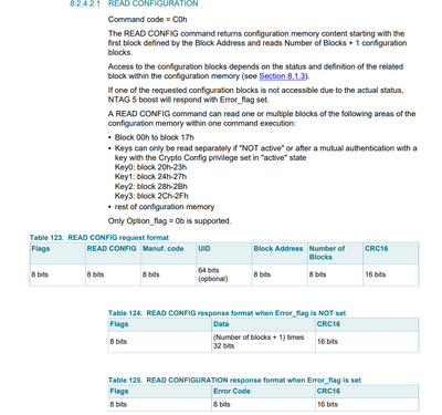

Hi @Ulysses HERNIOSUS ,
if i debug the code currently the rfalTransceiveBlockingTxRx(...) in rfalTransceiveBlockingTxRx(...) does not return an error (return value = 0).
Then it checks further down in this function if an error has been in the received frame (answer).
/* Check if an error has been signalled */
if( (rxBuf[RFAL_NFCV_FLAG_POS] & (uint8_t)RFAL_NFCV_RES_FLAG_ERROR) != 0U )
return rfalNfcvParseError( rxBuf[RFAL_NFCV_DATASTART_POS] );
The Value of the error_pos equals 0xF (dec. 15). For all my custom commands.
But i do not understand why. Therefore i guess it is a configuration problem of my used NFC I2C Bridge (NTAG5 Boost). Or what do you guess? Do you know what 0xF normally stands for? What does this error mean exactly?
Ulysses HERNIOSUS
according to ISO/IEC 15693-3: '0F' : Error with no information given or a specific error code is not supported.
I think the manufacturer DS should indicate more conditions when this 0Fh is reported. I think 8.2.6.2 of its DS indicates that "received command or option is not supported".
BR, Ulysses

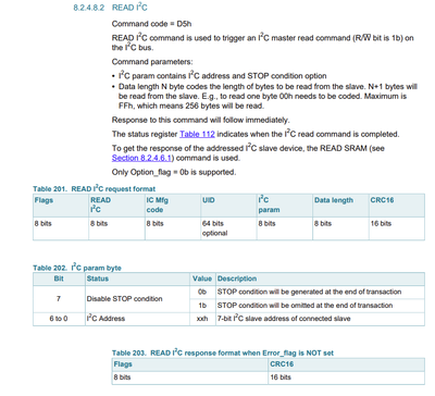

Thank you so much so far :)
So the Commands for ReadI2C and WriteI2C should be executed the exact same way using the rfal - right? Or am i understanding the rfal function wrong? rx / sizeof(rx) can be larger then needed - or might this lead to a problem?
So first i would write the ADC register i want to read out via WriteI2C and then immediately i would send a ReadI2C with the amount of data to read from the ADC (speficied by the ADC register).
// I²C bridge (0xD4/0xD5)
uint8_t tx[2] = { i2c_slave_addr, data_length_rx };
uint8_t rx[data_length_rx ] = {0};
ReturnCode rc = rfalNfcvPollerTransceiveReq( 0xD4,
RFAL_NFCV_REQ_FLAG_DEFAULT, // 0x02
0x04, // NXP mfg code
uid, // addressed mode
tx,
sizeof(tx),
rx,
sizeof(rx),
&rcv );
rx size should be at least two bytes bigger then needed when using ST25R39xx devices (as RFAL is internally using the Stream mode and does need to receive and check CRC in SW). It can be even bigger.
