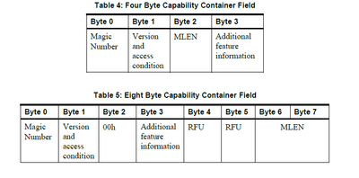

Rene Lenerve
Hi Jean4,
Reading your code I'm not sure that you are changing the I²C device code while switching between system and user area. Please refer to the Datasheet section 6.3 Device addressing and note the 2 addresses for user and system memory in the table.
Another point I noticed, is the CC file in Type V can have a length of 4 or 8 bytes. in your case you have defined a message len (byte 2 of CC file)  of 6 bytes so that implies the CC file length is of 4 bytes only.
I hope this can help you.
Kind Regards.

Rene Lenerve
Hi Jean4,
By device code I meant the I²C address of the tag, the user area and system area uses 2 different values of the device code to accessed it. Normaly your code should work.
For the CC file, if you read the tag with the MCU, you know the addresses of data, so you can read correctly the tag. But as you do not respect the NFC Forum Type5 standard if you try to read the tag with a smartphone (for example) through the NFC natively or with an app, the NDEF message will not be read.
The rule is if your NDEF message is lower than 2040 bytes then the CC file is on 4 bytes and the byte 2 (MLEN) can take values from 1 to 0xff (formula is : bytes = 8 * MLEN). If the NDEF message is higher than 2040 the CC file is on 8 bytes and the byte 2 values must be 0 then the size is coded on byte 6 and byte 7 (>0x0100).
The other bytes keep same position.
Kind Regards.

Rene Lenerve
Hi Jean4,
Your code is still returning that the session is already open, but no password has been provided before. Check what is the return value of st25dv_is_session_open(), check that the condition is working correctly (depending on bool typedef's "!st25dv_is_session_open()" can return different values, e.g. if bool is an int !0 = -1 and !1 = -2). If you have the possibility to spy the I²C communication it could help to debug also.
I don't know why you added this log afterwards ([00:00:00.476,013] <inf> st25dv_demo: I2C_SSO_EN_REG (0x0003) = 0x00), but register 0003 is for RF_MGNT and not I2C_SSO and its value is 0 by default.
For the CC file you split it in 2 cases, which is correct now but in the case the NDEF file is lower than 2040 the CC file is on 4 bytes an so you need to write the NDEF message at the offset 4 (and not the offset 8).
Kind Regards.
Sorry for the late response, i have adjusted the code accordingly and it still doesnt work, it is as if the chip is soft locked or something
*** Booting nRF Connect SDK v3.0.2-89ba1294ac9b ***
*** Using Zephyr OS v4.0.99-f791c49f492c ***
[00:00:00.477,264] <inf> st25dv_demo: ST25DV64KC Zephyr Example
[00:00:00.477,264] <inf> st25dv_demo: Checking I2C session status...
[00:00:00.477,539] <inf> st25dv_demo: I2C_SSO_DYN (0x2004) = 0xFF -> Session is OPEN
[00:00:00.477,569] <inf> st25dv_demo: Session already open.
