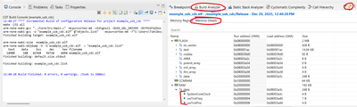

> I'm using STM32CubeIDE Version 2.0.0 and would like to get the size of all the object files in my build.
This is available with the default build settings.
After building, go to the Build Analyzer, refresh, then go to the Memory Details tab and you can see the size of each object.

Well, the information is there, but not as useful as I'd like. For my NXP projects, I get a listing, by object file, similar to the summary shown in the Console pane  for the .elf file, which I see the text, data, and bss usage.
I don't think it's broken down by compilation unit (*.o file) anywhere. Objects get removed by the linker so what's in the compilation units is not the same as what's in the final binary. Two object files can contain the same data so you can't just sum them up.
Perhaps you can show a screenshot of what you're looking for.

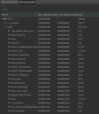

So this is not , what you want to see ?
jlthompson
Senior
No, it's not. What I want to do is run arm-none-eabi-size on each of the compiled object files. Looking at the build directory, it seems the .o files are not being retained, so I need them to remain so I can get their individual sizes. I'm fluent in shell scripting; I need to know the current working directory for the post-build step and where the files are so I can size them.

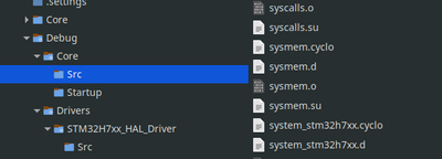

Ah, the files are in -> debug/.../src , see all "src" for core, drivers, middleware, third party, etc.
But afaik not very useful, as there is all of the libs etc., but the optimizer+linker takes only , whats used in target program. So this is more like a useless info about possible size.
What i showed , in "memory details" , is whats really used then.

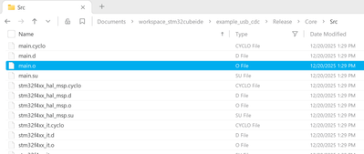

jlthompson
Senior
Arrrgh!! The IDE is to blame. File Explorer shows all the files, but the IDE takes a condescending attitude, showing only what it thinks I need.
I finally got what I wanted:
sh -c "arm-none-eabi-size  Core/src/*.o"
