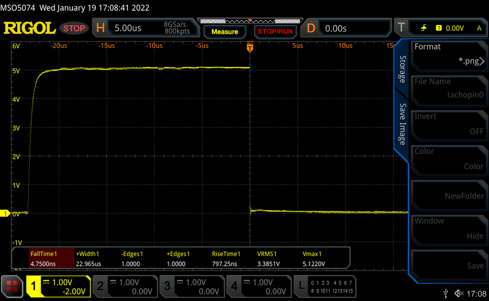

KNge.1
0693W00000JMrjYQAT.pngBased on the datasheet of Eval6235q (https://www.st.com/resource/en/data_brief/eval6235q.pdf) pg 4, Rpulse is given as 47k and Cpulse is given as 10n which I should get 282microseconds for tpulse. However, I couldn't get the value during my measurement, instead i only got 22.96 microseconds as shown in the picture. May I know what could be the reason?

I confirm that with the RC network of 47kOhm and 10 nF you should get a tpulse of about 280 us.
Are you measuring the pulse connecting the probe directly on the TACHO pin (only with the pull-up resistor connected to VDD)?
Could you check if the pulse is correctly synchronized with the H1 signal?
