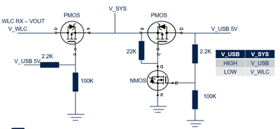

Also you can refer to this
Solved: Using a STWLC38 with an optional USB-C charging - STMicroelectronics Community
