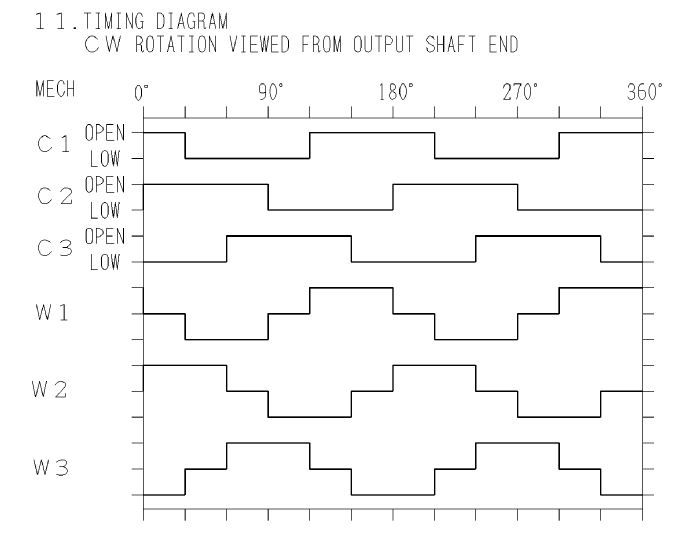

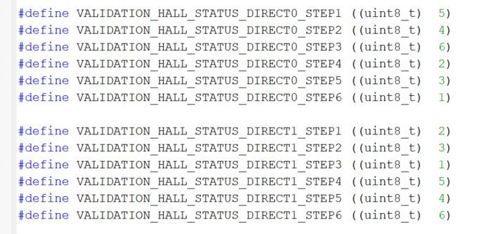

I now have a compiled firmware image however starting it on either of my PTOOL1V1 will only move the motor 1 step and then it will shut the motor down. Switching the Trigger input does much the same.
It seems to me that I have missed something basic. Any idea what?
ADAVE.1
0693W00000WJPuPQAX.jpgHi jc,
that usually happens when expected sensor status doesn't match with acquired status.
This may due to either a wrong connection or a wrong Hall sensor decoding table.
Supposing that all the connections are OK (phases U, V, W and signals H1, H2, H3), I suggest you to have a look to the decoding table included in the file 6step_synch_hall.c and here above attached. This table gives the correspondence between hall sensors status and step. For your understanding, steps and sensor status are defined as indicated in the manual of motor Shinano LA052 (also attached) where step1 corresponds to W1 high, W2 low and w3 floating, and DIRCT0 is the clockwise direction0693W00000WJPyqQAH.jpgBeside this, in case that the fault might due to an overcurrent event at start-up, I would also recommend to reduce the PI gains of the speed loop.
