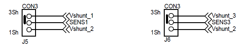

hi I have the ihm08m1 how can I change from 1 shunt to 3 shunt if by default it is soldered on 1 shunt?
Peter BENSCH
Simply set the solder jumpers J5 and J6 accordingly (next to R43/R45), i.e. both to 3sh:

Cristiana SCARAMEL
Hello @SDall​,
the selection for single/three shunt configuration is made with J5 and J6 jumper.
You have to move the tin drop on the 3Sh side.
Fore more details you can refer to the user manual UM1996

SDall
do you have to do it with the welding machine?
Yes, J5 and J6 are solder bridges.
