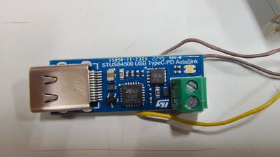

Hello AshutoshK,
May I ask you to share a picture of the board you are using ?
As per the snapshot shared, it seems it is eval-scs002v1 and not eval-scs001v1.
As eval-scs002v1 is stusb4500L which is TypeC only: you will never be able to get more than 5V.
Best rgeards
Nathalie

Hi Nathalie,
The Eval board I ordered is EVAL-SCS001V1 (image attached below) but in the GUI in connection status why it is showing STUSB4500_L don't know instead it must show STUSB4500. Don't know if this is creating an issue?
I think the device I have ordered is right!

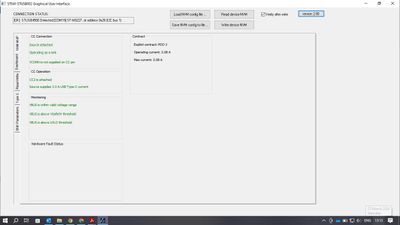

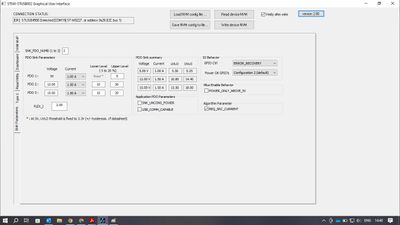

Also I have an update, my configuration worked and I got +12V at the output. In dashboard window its showing PDO3 is selected (Attaching screen shot for your reference). I have changed the source to PD compatible.
So basically what I have understood is the source which we are using must be compatible to sink i.e the source must have USB PD 2.0 if your sink is PD 2.0. I have also tried on source supporting latest PPS technology having the required output profiles but it didn't worked with eval-scs002v1. To work with the sink having PD 2.0 source must be PD supported. I have one doubt please enlighten me on this., In STUSB4500 datasheet it is given PD2.0 , PD3.0 compatible then why it didn't worked for PPS. As PPS is extension of the PD3.0 what I think it must work.
I have one observation regarding NVM PDO configuration. I have connected the load to the output of eval-scs001v1 which I measured and found 12V. In the Dashboard of GUI it is showing "Explicit Contract with PDO 3". But on PDO3 I have configured 15V profile and on PDO2 12V. What can be the possible cause that profile Explicitly selected is PDO3 but the output I'm getting at eval-scs001v1 is +12V, it must be +15V according to the selected PDO3.

Hello
All PD3 sources support also PD2. Please note that 12V is not a mandatory voltage node. Only 5-9-15-20 are, depending on source power. So most probably, PD3 source which you are using does not provide 12V as fix PDO: that's why you cannot get 12V at stusb4500 output. (see
STUSB4500 algo selects fix PDO based on source fix PDO offer.
As fix PDOs power rules and object are same in both PD2 and PD3, our sink works with both PD2 and PD3 sources.
stusb4500 is not able to get PPS voltage because PPS PDO is only a PD3 object.
The PDO number refers to the request sent by STUSB4500: it has requested 3rd source PDO which was, in this case, 12 volt.  15V will be 4th PDO of the source as they need to by ordered by increasing voltage. 9V is the second.
