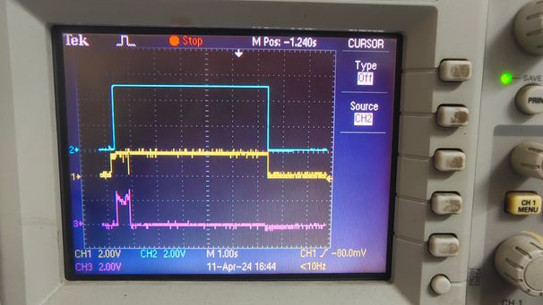

Here is the oscilloscope capture of issue.
Blue: VBUS = 5V
Yellow: CC2 = Around 2V
Pink: VSNK = 2V spike
In the above case as we could see that the FET is not turning ON. On VBUS there is 5V constant and on VSNK there is just a spike and no voltage where as CC1 is constant around 2V.

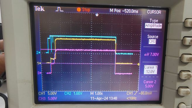

Below is the capture of Normal Condition waveform
Blue: CC2 =1.7V
Yellow: VBUS = 12V
Pink: VSNK = 12V
Please not No Load is connected to the VSNK in both the conditions.

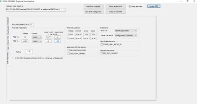

2024-06-03 12:59 AM - edited 2024-06-03 1:01 AM
Yes, this is 35W source with 20v, 1.75A and 15V, 2.33A.
I have surpassed 9V and 12V profiles and in GUI I have set PDO's as given in image below.
I have tried 15V 0.5A, 15V,1A , 15V 1.5A, 15V 2A. But nothing worked. Tried entering current value lesser than source current for 15V and 20V it also doesn't worked.
2024-06-03 1:05 AM
Please provide the NVM content you used.
Best regards
Nathalie
2024-06-03 6:27 AM
Below is the NVM content I used. I have also tried with PDO 15V, 2A .
2024-06-03 6:32 AM
Looks OK.
Did you take care to remove all supply of stusb4500, to guarantee NVM download after it has been written ?
Nathalie
