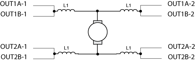

So, if you want to parallel different devices you have to compensate the effects of timings mismatch.
For example you could try to add a small inductance (an order of magnitude smaller than the motor inductance) in series to each two half-bridge output of same devices:
This configuration must be verify with bench tests.

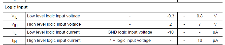

Concerning the value of the RC network on ENx pin, the recommended value is 100kohms.
But, the datasheet gives a low level logic input current of 10µA.
If we apply this on the Enx pin, this means that the voltage across the REN resistor could be 100kohms x 10µA = 1V
In my case, as I use 4 bridges in parallel, the 4 Enx pins are tied together and my input current could be 4x10µA = 40µA.
I could have 4V accross the REN resistor. This value is much higher than the Low level input Voltage(0.8V)! That's why I used a smaller resistor.
But perhaps I'm wrong and the ENx pin is not considered as a logic input ? So I could keep the 100kohms resistor?
Hello @Fabrice Comby​ and happy New Year.
To reduce the timings mismatch effects you could parallel all half-bridges of a single device to drive one side of the motor and another L6206 to drive the other side (refer to L6206 datasheet at page 20 Figure 17).
Concerning the low logic level current I checked the parameters distributions for both EN pins and the measured current is about zero (some tens of nA).
I agree that the limit in the datasheet is misleading, anyway I confirm my suggestion to use 100 kohm and 5.6 nF for RC network on the enable pins.
