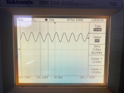

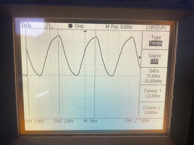

The frequency of "LTDC_CLK" changes by itself after waking up from "deep suspend".
Before putting it into "deep suspend", I measure 31.65Mhz which corresponds well to what is expected for "innolux,at070tn92"
But after waking up, i measure 86.21Mhz and this is completely outside the display specifications.
All other frequencies changed in the same proportion "HSYNC", "VSYNC", ...
