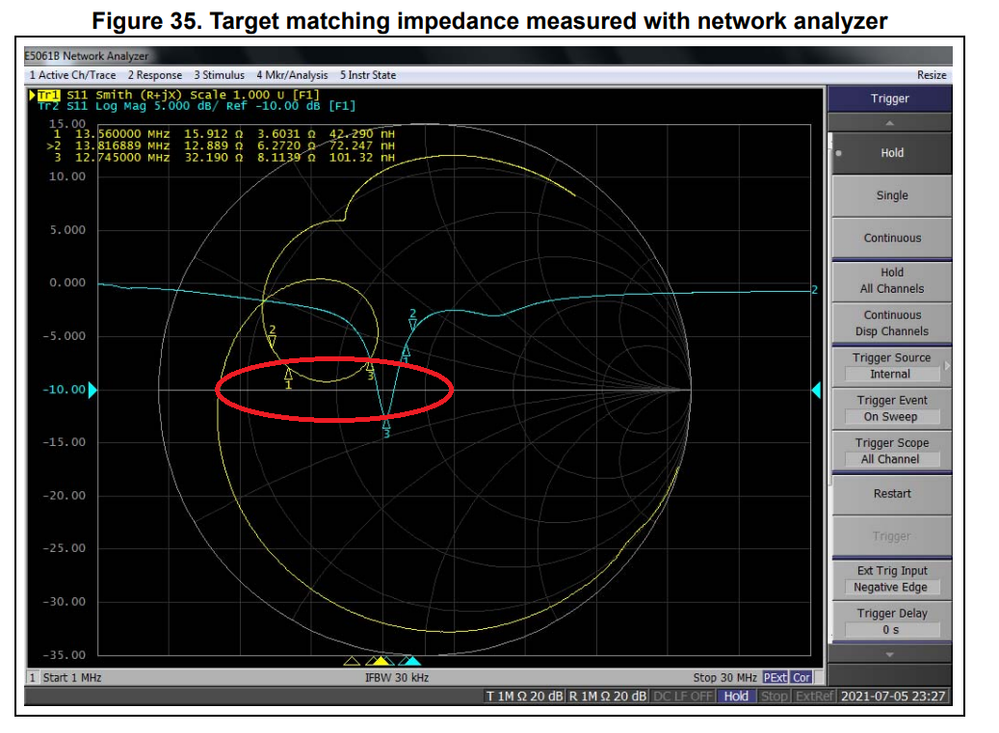

The measurement is described in chapter 7.4 / Figure 34. I will foresee a reference in the next revision of the document. It is the same condition as for the antenna measurement. As long no GND connection is in place between board and VNA, you can use a single ended measurement. Since the IC is high-ohmic when being un-powered, there is also no need to disconnect it for the measurement.
You may want to tune your reader somewhere in the marked area:
If your matching is outside of this area, the current and voltage going through the driver transistor are not in phase anymore. The system might get slightly inefficient. Also when going further away, due to the inductive or capacitive load you might face issues with the waveshapes. Overshoots or ringing might occur.
This is the reason why we recommend to stay within the red marked area.
BR Travis.

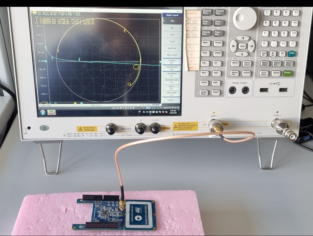

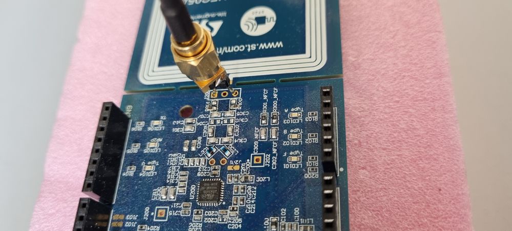

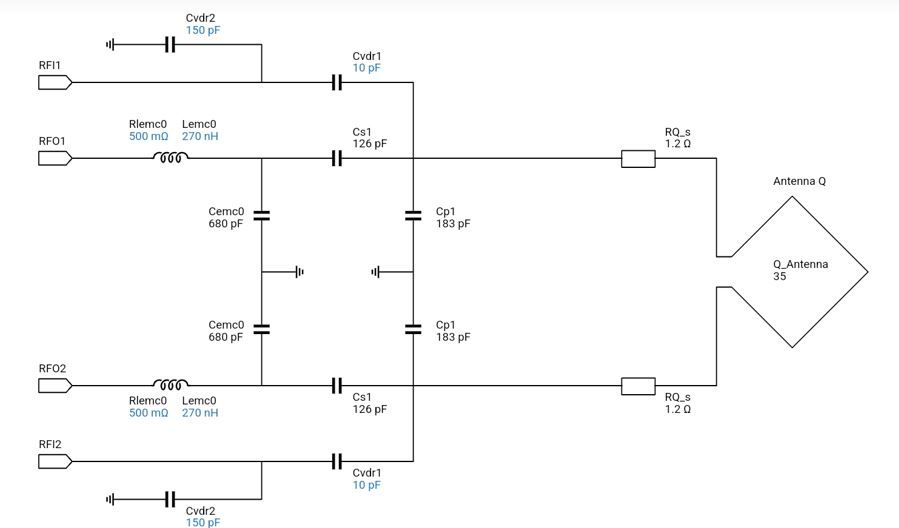

Interesting.  Can you explain on this schematic where to solder signal and ground from coaxial cable on PCB?
Hello RFlod.2,
Below you can find the schematic and some pictures based on a NFC05A1.
To disconnect the antenna from the matching network, I opened R300 and R301.
BR Travis

I see the chapter but wonder two things:
* Where on the schemantics shall these measurments be done
* How do I know matchning is good
Travis Palmer
Hello RFlod.2,
