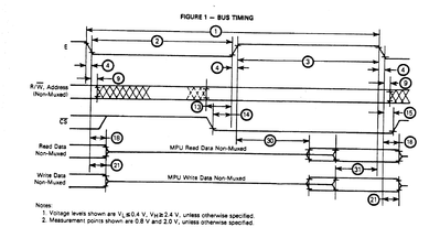

I can't see something related to E (Enable pin ) except this timing in the MC6821 datasheet:
So pulse width low and high are specified as minimum. I think no need to use a timer for that use a simple GPIO + delay and ensure you respect this timing.

From my experience, the way to go is to use hardware PWM output for E signal and do all the rest in timer's ISR - data bus direction, R/W, RSx lines and data input/output, as described in my first post. Ok, maybe it's easier to handle E in software to avoid worries about timing details. Minimum E frequency is 100 kHz, so you have plenty of time - 360 cycles for each E edge to be exact - enough for execution of at least 20 lines of simple C code. Just design a nice state machine for that. ;)

Not sure if it's something that could fit the chip requirement timings:
E, CS, RW signals needs to follow this diagram:
So I don't think using MCO + handling the GPIOs (set/reset) will fit this timing!
E determines a cycle of read/write here.

Overkill. F103 may handle MC6800 bus at up to 200 kHz using interrupts without any trick. :)
