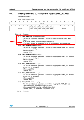

waclawek.jan
This is not a bug, it's how the 'F1 GPIO works.
The 'F1 family was the first STM32 family, and its GPIO is a very simplistic design (GPIO in all newer STM32 has a different, more coherent design): the individual modules (like TIM, I2C, SPI, etc.) output signals are simply OR-ed together. Some modules have individual enable bits for their outputs, e.g. in TIM (TIMx_CCER.CCxE), so you can enable the module but not enabling its output it won't influence other module's signal at the same pin; but many modules don't have such individual enables, and all their pins are enabled at once. This is also the case of FSMC, where, once you enable its clock in RCC, its signals start to "occupy" the pins where it is connected.
Pin PB7 is FSMC_NADV, which is used only in (relatively rare) multiplexed-bus designs. ST is aware of the fact that enabling FSMC would occupy PB7 even if you don't need FSMC_NADV signal, so you can disable it by setting AFIO_MAPR2.FSMC_NADV (don't forget to enable AFIO clock in RCC before writing to its registers).
