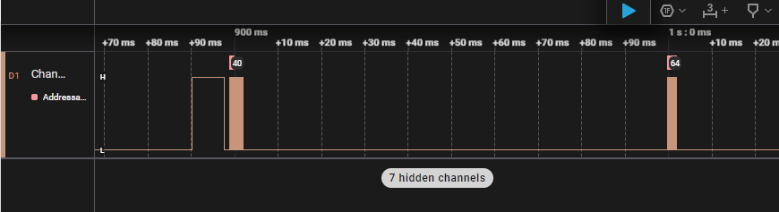

Immediately after power-up, some LEDs (LED 41 an 10-12 following) light up before WS28XX_Init() is even called.
On the logic analyzer, I can see a valid WS2812B data burst right after startup,
covering up to LED 40 with "0", followed by a ~100 ms gap,
and only then my actual data frames appear.
Once WS28XX_Update() runs, everything looks correct and stable.
Questions:
  • What generates this initial data burst on the PWM pin?
  • Could TIM3 or DMA be triggered automatically during startup?
  • Does CubeMX initialize the PWM channel before main() executes?
  • Has anyone seen similar behaviour with WS2812B + DMA on STM32?
You, or your program.
If there is a command to do this - yes; maybe HAL_xxx_Transmit_DMA , HAL_TIMxxx_Start...
init - yes :  MX_TIMxx_Init(); but not start it.
Just debug the start/init, check output with scope; then you know, where the unexpected "send" coming from.
So its coming from using the WS28xx lib , as TIM or DMA have no native mode to send valid WS pattern.
