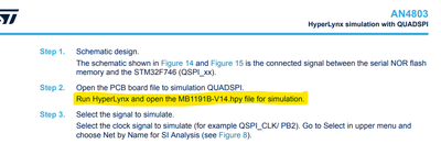

Hi Hariom,
Could you please provide me more details? It's a bit unclear to me. Are you talking about this part?

Hi ELABI.1,
Thank you.
Yes I am talking about that file you highlighted.

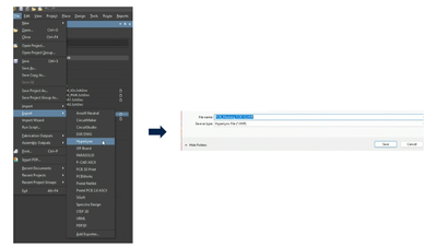

Actually, this file isn’t provided on our side, you have to generate it yourself using your editor.
For example, you can generate the .HYP  file with the Altium tool for your board. Here is a screenshot showing this:
 After that, you can upload this file to the HyperLynx tool to run the simulation.

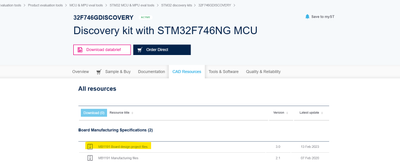

Here is the link, download the MB1191 Board design project files as shown in the screenshot:

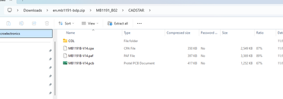

And here you will find the .pcb file, as shown in the screenshot:
