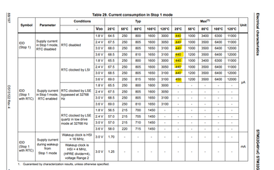

@abhijith_raj
The current consumption in STOP1 mode is described in the table below:
