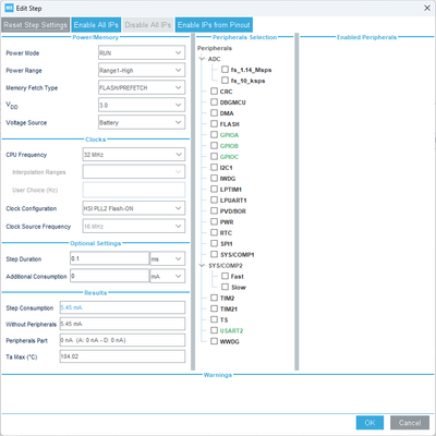

STM32CubeMX has a power consumption calculation tool which shows the nuts and bolts:
You may also check this app note: STM32L0xx ultra-low power features overview
and knowledge base article: Tips for using STM32 low-power modes - STMicroelectronics Community
hth

Thanks for your answer.
I saw that, but my asking is more about a listing at any instant of powered clock/gpio/... STM32 cube mx can help me about that, but can't show the reality at an instant if i make modification in the code.
Which is different with a specific function or library which could printf a result. For example, it could be :

I see. Not aware of library code. You may check the peripheral register view in the debugger before actually entering a low power mode, especially the RCC registers.
hth
KnarfB
Indeed.
@Frog or you could have your code read those registers for you ...
