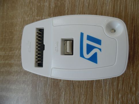

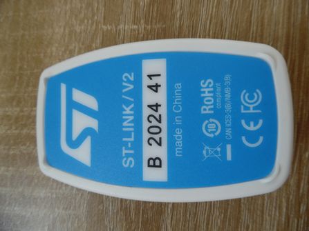

Please post a photo of the back of your ST-LINK/V2.

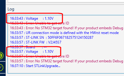

With a target voltage of 1.10 V, your board isn't going to be running.
You will need to power the board separately. The programmer typically does not provide power.

@Peter BENSCH here are some pictures

Your log shows that your target has insufficient supply voltage:
At that voltage, the target can't run - so it can't communicate with the debugger.

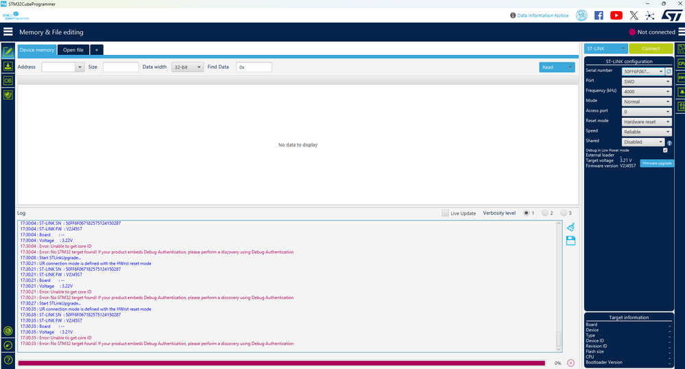

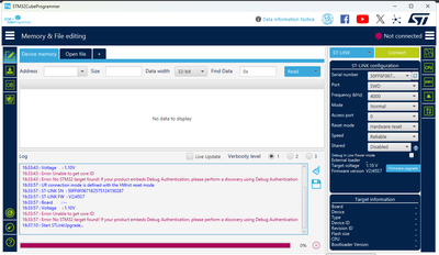

I waited for the 230V sensor to start up, then the 5V communication card, and there it was, I now have 3.3V :Capture d’écran 2025-05-12 173106.png
