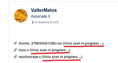

I've attached the compressed file.
Most people don't like 1) downloading 2) unzipping 3) ... stuff.
As Andrew said, please post relevant source code:
- variable declarations
- DMA calls
Edit: maybe also your linker file, maybe there's a wrong RAM size setting.
@ValterMatos ,
As stated previously there is an issue with the attachements these days:
We cannot download any of your attachments, so better to post your code using </> button.
Read How to insert source code
You need to share your linker file + the code.

Attached are the .ld, .ioc, and main.c files.
Show oscilloscope.h content.
We need to see the definition of the Oscilloscope structure:
Oscilloscope oscilloscope;
I suspect a large buffer declared as a member of that structure
