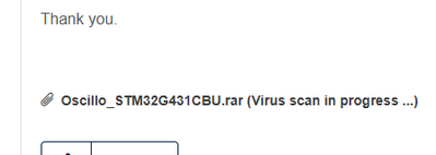

I've attached the compressed file.
Thank you.

On a loosely related note, the recently displayed message "Virus scan in progress..." for attachments suggests no such scan had been in place before ...
Unfortunately, your project is stuck in the virus scan:
See: Attachments stuck on "virus scan in progress..."
