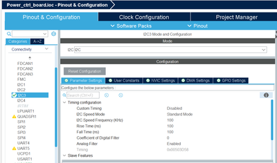

I’m currently working with an STM32G4 MCU and the BQ7697202 BMS IC, and I’m trying to establish basic I2C communication between the two. According to the BMS IC datasheet, I’ve configured the I2C address correctly, but I’m still unable to detect the IC on the bus.
Additionally, I implemented an I2C scan to search for available devices, but the scan returns “No device found.” Please find the attached I2C configurations for the reference.

Welcome to the forum.
Please see How to write your question to maximize your chances to find a solution for best results; in particular, please provide full hardware details and show your code.
Have you used an oscilloscope to verify your I2C waveforms? In particular, this will show if you have pullup problems.
Have you used an analyser (or the scope) to verify your I2C comms?
Have you tested it with any other I2C devices?

Ensure pullups in the 1-5 kOhm range are present on SDA and SCL. Internal pullups are not sufficient.
Ensure pins are wired correctly.
Ensure target board is powered.
Show pictures of setup.
