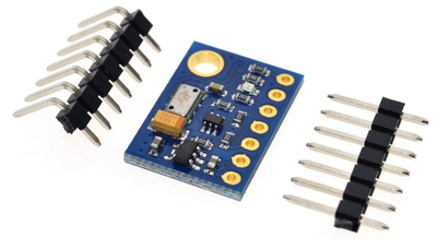

@santhosh16 wrote:
hey andrew, thanks for the reply i check with the team yes its the problem with the oscillator.
OK - I'll edit the title to clarify.
@santhosh16 wrote:
 now, if i get data from the prom register how can i ...
That's an entirely different question!
You won't be able to do anything at all until you have fixed the clock problem.
For how to communicate with the MS5611-01BA03 mems sensor, and interpret the data from it, you will have to study the manufacturer's datasheet & any other supporting information.
The MS5611-01BA03 is a TE product - nothing to do with ST - so you will need to contact TE for support with it.
The recommended approach would be to get a development/evaluation kit from TE, and use an ST board (eg, Nucleo) to get you started with known-good hardware.
It seems that 3rd-party breakout boards are also available; eg,
https://www.amazon.co.uk/MS5611-01BA03-Atmospheric-Pressure-Altimeter-Electronic/dp/B07Y1QZKF4
@santhosh16 wrote:
 the problem with the oscillator. now
Are you, perhaps, getting confused with which oscillator we're talking about here?
The one which causes the SystemClock_Config() to fail is the one within your STM32.
The MS5611-01BA03 mems sensor does also have its own internal oscillator - but that has nothing to do with this problem.
