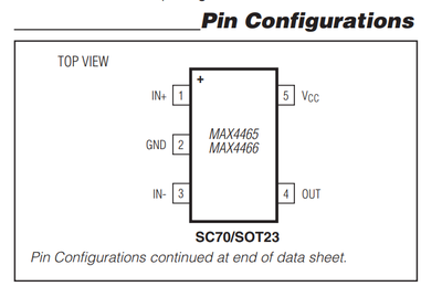

@user_01 wrote:There are only 3 pins Vout, Vcc and Gnd.
No, the MAX4466 has five pins:
https://www.analog.com/media/en/technical-documentation/data-sheets/MAX4465-MAX4469.pdf
So, presumably, you are not talking about just a MAX4466 - but some board or module which contains a MAX4466 (and, presumably, also a microphone and other components) ?

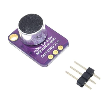

‎2024-12-11 1:23 AM - edited ‎2024-12-11 1:27 AM
Yeah, it's a module with mic like the adafruit one you've mentioned. The picture and the link is as below.
The connections are very simple :
PC6 - OUT
GND - GND
5V - VCC
PC6 can be used as ADC1's 15th channel as mentioned in alternate function table in the datasheet .

Most likely, that will be just a copy of the Adafruit module.
The trouble with buying cheap copies like this from the likes of Amazon is that you get no documentation and no support - you gets what you pays for!
But the Adafruit documentation will probably apply - so start by studying that:
https://www.adafruit.com/product/1063

I just have the original STM32F411E discovery board (blue color) and STM32F411E is the link to the site I bought my board from.
Actually I bought the MAX4466 module in a local shop nearby which was obviously brandless but not in amazon. I just want to do name specific word wake up (Edge impusle) using a mic with STM32F411E as the MCU. It's really insane like I can't even get the voice input to process the data in the first place.
