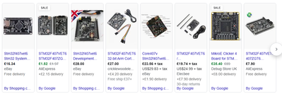

Andrew Neil
@ose7b wrote:
 the "Black" STM32F407VET6 board,
anyone can make a black board!
Is it one of these:
please give a link to the one you're actually using.
More useful to have the supplier page for the board you actually have.
Does the board documentation not give a specification for the supported LCDs (vain hope) ?
I have ordered the board from this supplier: https://robu.in/product/stm32f407vet6-arm-cortex-m4-core-with-dsp-and-fpu/
The datasheet they link to is just the microcontroller datasheet. In there I just see that it has a FSMC interface with 8080/6800 modes.
Also found this page https://stm32-base.org/boards/STM32F407VET6-STM32-F4VE-V2.0.html but doesn't seem very useful.
