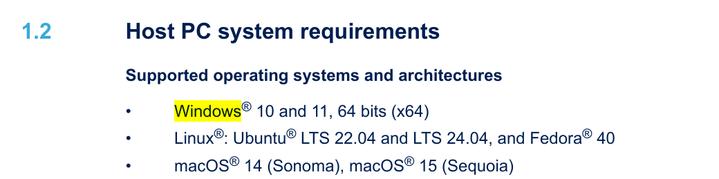

I installed STM32CubeIDE and every time when I want to start it, it crashes after two minutes. I found one solution related to the workspace here in ST community, but it doesn't work for me. Last few days I am trying to solve this problem, but without succes.
Can anyone help with that? ST experts?
I am using Windows 8.1 (64-bit) and Java 8 (64-bit). All is updated...
In attachment are error files where is possible to detect the problem. Please, help with that?
Thanks in advance!

8.1 cant be updated ... is out of 1/2023 And you dont show IDE version ?

Ok, maybe it is misunderstanding....I regurarly install all updates that Windows ask me.
Version of IDE is 1.17.0
For more details you can check error files in attachment,
https://www.st.com/resource/en/release_note/rn0114-stm32cubeide-release-v1170-stmicroelectronics.pdf
if you require stay on 8.1 read this release and find IDE version with support 8.1
