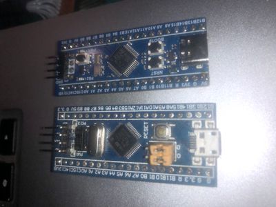

Error: Data read failed - when connecting to STM32F103C8BT6 Blue Pill
chriskuku
Senior III
Title edited to flag that this relates to a Blue Pill
I'm trying to connect an STM32-STLink-V2 with three wires via SWD (GND, SCLK,SDIO). Was able to run a firmware upgrade, now V2J46S7.
Clicking on Connect gives:
15:35:11 : UR connection mode is defined with the HWrst reset mode
15:35:11 : ST-LINK SN  : XXXXXXXXXXXXXXXXXXXXXXXXXX
15:35:11 : ST-LINK FW  : V2J46S7
15:35:11 : Board       : --
15:35:11 : Voltage     : 3.02V
15:35:11 : SWD freq    : 4000 KHz
15:35:11 : Connect mode: Normal
15:35:11 : Reset mode  : Hardware reset
15:35:11 : Device ID   : 0x410
15:35:11 : Revision ID : Rev X
15:35:11 : Debug in Low Power mode is not supported for this device.
15:35:12 : UPLOADING OPTION BYTES DATA ...
15:35:12 :   Bank          : 0x00
15:35:12 :   Address       : 0x4002201c
15:35:12 :   Size          : 8 Bytes
15:35:12 :   Bank          : 0x01
15:35:12 :   Address       : 0x1ffff800
15:35:12 :   Size          : 16 Bytes
15:35:12 : UPLOADING ...
15:35:12 :   Size          : 1024 Bytes
15:35:12 :   Address       : 0x8000000
15:35:12 : Read progress:
15:35:13 : Error: Data read failed
15:37:13 : Disconnected from device.
What's wrong?
It turned out far less complicated: the RDP bit was set. After unticking it using STM32CubeProgrammer, I was able to read the device.

> What's wrong?
You probably have a counterfeit chip and/or programmer.
Programmer reports a voltage despite no VCC connected, so maybe you're using this?
Non-ST tools often don't work will with newer software.
Andrew Neil
You need to give more details about your setup - see:
How to write your question to maximize your chances to find a solution
As @TDK said, the STM32F103C8BT6 is widely cloned, and there are many fake ST-Links out there.
This was discussed at length recently in this thread
And this thread
And this thread
See also: How to recognize a genuine ST-LINK/V2 versus a cloned one.
I'm using this:
That one looks counterfeit as well, unless the markings have changed.
How to recognize a genuine ST-LINK/V2 versus a clo... - STMicroelectronics Community
Plus the board is likely counterfeit.
@chriskuku Note that you can put the image directly in the post - then we can see it:
That's a fake - see this post by @mƎALLEm
You still haven't said what board you're using
Either of these - the newer one is a WeAct Studio
In the end it turned out that the bluepill I was using was faulty. Dropped in another one and things vanished into thin air.
So if your problem is now solved, please mark the solution on the post which provided the answer - not this one!
Note that Blue Pills are not ST products, and likely don't contain a genuine STM32.
Therefore ST tools may not (fully) support them - see this thread.
