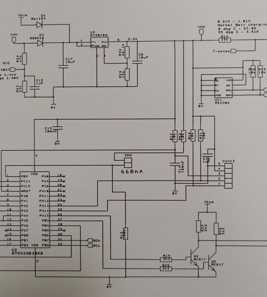

I am using M24C04 chip and downloaded the software package EEPRAM2.
if(EEPRMA2_M24_Init(EEPRMA2_M24C02_0) == BSP_ERROR_NONE)
	  chip_ok=1;
	 // DOUBLEFLASH();
 else
	 chip_ok=0;
 if I used this instance it says chip ok=1 but the  read and write not working .As using M24C04 ,I also tried the instance as
if(EEPRMA2_M24_Init(EEPRMA2_M24xx) == BSP_ERROR_NONE)
	  chip_ok=1;
	 // DOUBLEFLASH();
 else
	 chip_ok=0;
it says the chip is not working

meena
void testEEPROM()
    // Write data to EEPROM
    if (HAL_I2C_Mem_Write(&hi2c1, 0x50, memAddress, I2C_MEMADD_SIZE_8BIT, dataToWrite, 2, 1000)== HAL_OK) {
        // Handle Write Error
       i2c_write=1;
        return;
    // Read data from EEPROM
    if (HAL_I2C_Mem_Read(&hi2c1, 0x50, memAddress, I2C_MEMADD_SIZE_8BIT, dataRead, 2, 1000)== HAL_OK) {
    	i2c_read=1;
        return;
    // Check if the written data matches the read data
    if (dataRead[0] == dataToWrite[0] && dataRead[1] == dataToWrite[1]) {
        i2c_test=1;
    } else {
    	 i2c_test=0;
Hi I tried this to but i dont know why its not working
The EEPROM address should be shifted - 0xa0 instead of 0x50.
Again, please pay attention to the Posting Tips:
https://community.st.com/t5/community-guidelines/how-to-write-your-question-to-maximize-your-chances-to-find-a/ta-p/575228
You need to give details of your hardware setup - it might not even be a software issue.
And tell us what investigation/testing/debugging you have done to find the problem(s).
Have you used an oscilloscope to check what's happening on the wires?
You're just checking for the HAL_OK return value
  • Are your HAL_I2C_... calls returning HAL_OK ?
  • If not, what are they returning? What does that tell you?
WhatsApp Image 2024-12-03 at 12.13.16.jpegthis is memory chip connected to the MCU U11 is the memory chip .Can you please tell me the I am using the  correct software.I have downloaded EEPRAMA2 which says instance as M24C02 probe
