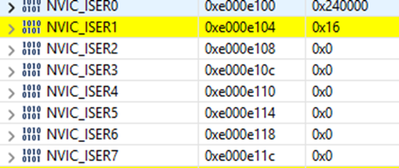

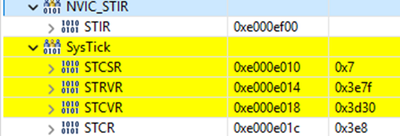

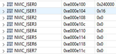

Systick works...

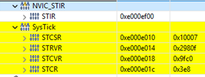

Systick doesn't work...
nSWBOOT0 0 => systick works
nSWBOOT0 1 => systick doesn't work
Seems like problem with vector table when leaving system bootloader. Don't have time for this right now. Will just clear nSWBOOT0.
