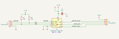

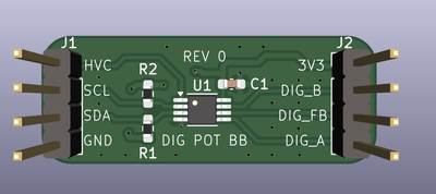

I recently created a digital potentiometer breakout board for the MCP4541-104E/MS, where I would set the resistance value dependent on a particular wiper value. Here is the schematic and layout (I changed the pullups from 10k to 4.7k):

I am using PB6 as my SCL and PB7 as my SDA on the Nucleo L476RG. I have HVC/AC pulled to ground and wiper pin B pulled to ground. The POW pin is connected to a green LED with a 1k resistor tied to ground. P0A is floating.

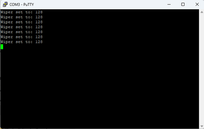

The resistance value across P0A and P0B is 100k and P0A and P0W is 50k, regardless of what I set the wiper value to. I checked the SCL and SDA lines with a scope and I am getting signals sent every second, and the UART terminal outputs the following:
I'm unsure what is missing in my code or setup, any help would be appreciated.
