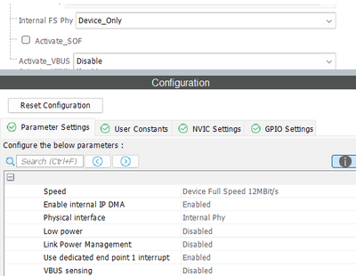

I’m a beginner working with the STM32H723ZG, and this is my first time trying to implement USB functionality. I’m attempting to set up the USB peripheral in Device mode (CDC) to send audio data from a buffer (filled by SAI via DMA) to a PC.
I’ve configured the USB in Full Speed (12 Mbit/s) mode using the internal PHY in STM32CubeMX and generated the initialization code. However, Windows fails to recognize the device, showing the error "USB device not recognized". I have also downloaded and installed the STMicroelectronics Virtual COM Port (VCP) driver to ensure proper communication.
I found out that the error occurs specifically during the call to MX_USB_DEVICE_Init(); in the initialization process.
After debugging, I traced the issue to the function USB_CoreReset() in stm32h7xx_ll_usb.c, which times out.
USB Configuration in CubeMX:
The clock for USB is set to 48MHz.
I have no idea what I’m missing… Have you got an idea?

How is VDD33USB connected and how do you manage it in software?

I’d like to clarify that I have carefully read the reference manual for the microcontroller. However, I don’t fully grasp all the details regarding the specific parameters required for the registers (which is why I mentioned that I’m a beginner).
I have also reviewed the Nucleo-H723ZG board documentation, and as far as I understand, it handles powering the USB automatically. This is confirmed by the LED indicator, which shows that the USB power supply is active on the board.
Regarding the initialization process, I used STM32CubeMX, which generates the USB initialization code based on the parameters entered through its graphical interface (as shown in the screenshot I attached in my first post). I’m also confident that the USB clock is properly configured to 48 MHz, as required.
Since the initialization function is auto-generated, I came to this forum to check whether any of the parameters I’ve configured in the graphical interface might be problematic, or if there are any known issues or manual adjustments needed to make the generated code work.
