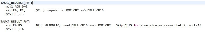

SPC5 and using SPC572L we have problem with DPLL channel 16 - SPC5_GTM_DPLL_ACTION_ID_15 not working
Larsa
Our SPC572L application are using both MCS1 & MCS2 connected to DPLL and ATOM it works well on all 16 channels except the last one: channel 16 "SPC5_GTM_DPLL_ACTION_ID_15" if we change to ch17 "SPC5_GTM_DPLL_ACTION_ID_16" it runns fine but we need to use all 24 channels soon with the SPC572K device.
Is there a known workaround?
/Lars

Errata sheet are available on web-site:
https://www.st.com/en/automotive-microcontrollers/spc572l64f2.html#documentation
Some work around in the DPLL area, one of them could be useful for your issue.
