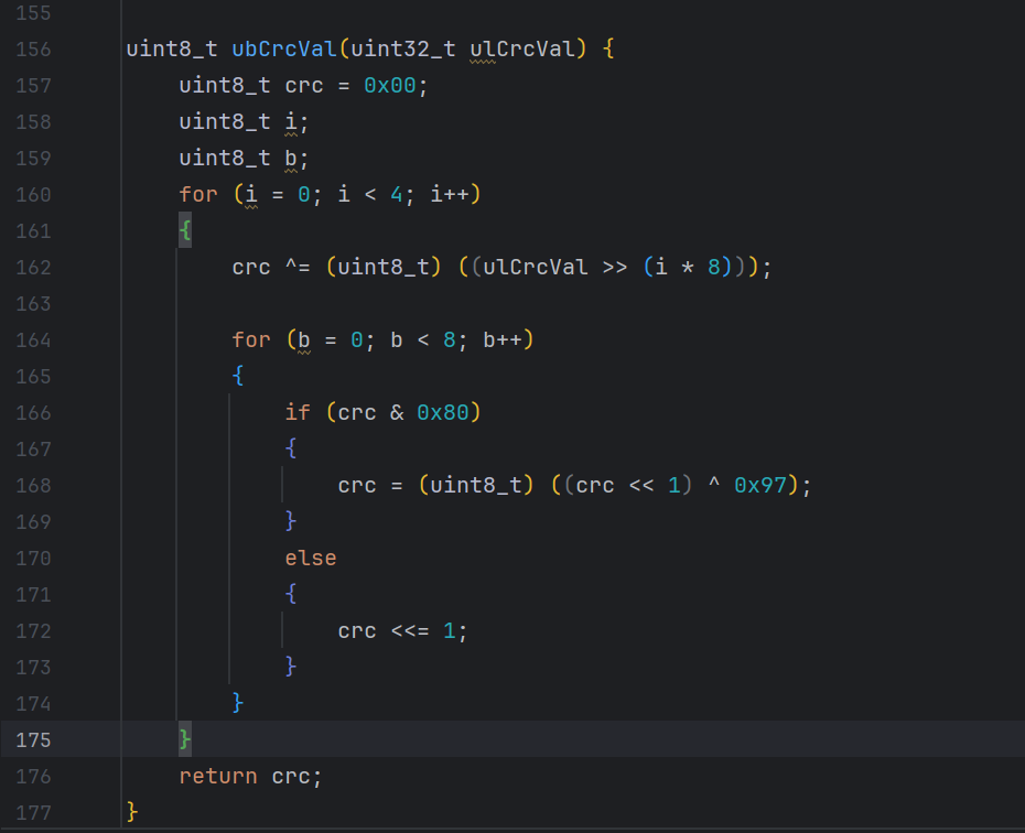

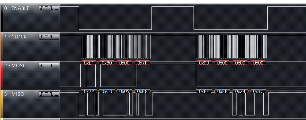

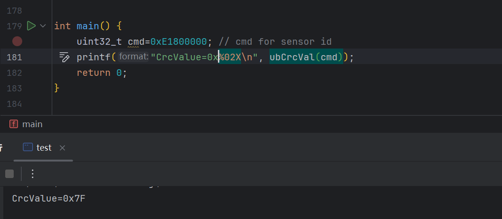

Why are my CRC verification and device ID reading wrong?
Yz2
Visitor
Split from AIS2120 reading issue - This question doesn't seem to have anything to do with that thread
@JHo.1 and @Eleon BORLINI @CJeff.1
Could you please help me check why my CRC verification and device ID reading are incorrect? Thank you very much!wechat_2025-09-30_123024_833.pngwechat_2025-09-30_123322_374.png微信图片_2025-09-30_111851_590.png
