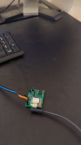

Hi, I am using the LSM6DSV16BX IMU on a project where I need the Game Rotation data.
I used the Github examples as a base, and reading the Game Rotation values works well and I am able to save the quaternion data in a file. I wrote a little script that takes the Game Rotation quaternion values and applies the orientation to an object, to mimic what is possible in Unico GUI with STEVAL-MKI234, however I do not get the same performance with my custom board. For instance, I sometimes get some weird rotations around two axis even though I rotate the device around a single axis. See video:
I was wondering if any special setup was required to achieve this kind of performance ? Is there any calibration that can be made ?
I configure the Accelerometer and gyroscope to 960Hz, but batch samples of Accelerometer, Gyrometer and Game Rotation data at 120Hz in FIFO. I realize this is not much information to try and help me, I am more than happy to provide more detailed information if needed, any advice is appreciated.

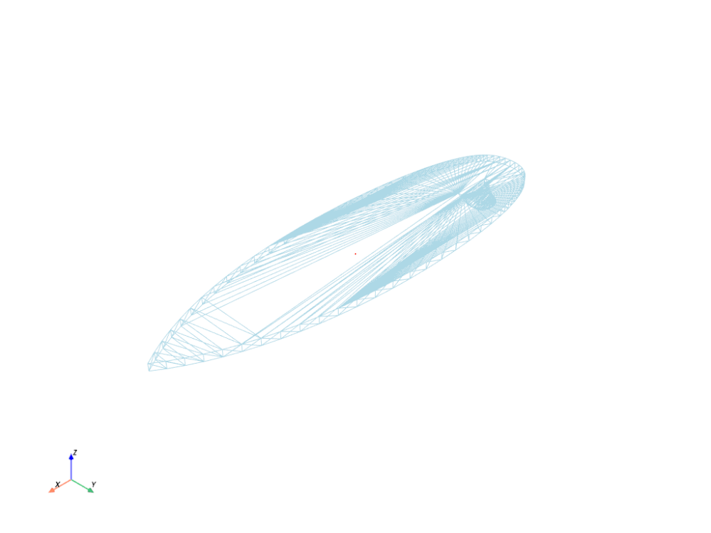

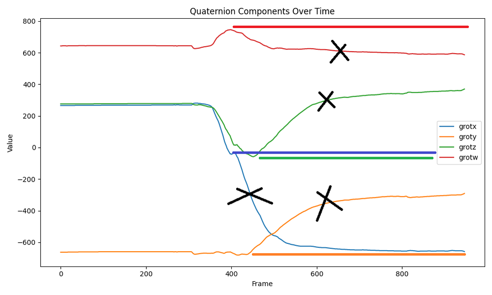

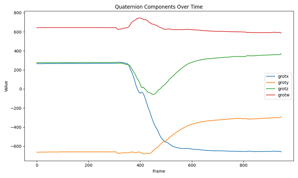

To recap my issue (as after reading my first post it did not seem super clear...), here is a video of the movement I apply to the device:
Here is a plot of the quaternion data I read from the device corresponding to this movement:Quaternion.png
I have a script that displays a 3D model of a surfboard and orients it according to the received data, which looks like what is in my original post. You can see rotations around two axis, where I only rotate the device around one axis.
I would have expected the graphs to look like this:
That is, the quaternion data stabilizes after the move. It is what I observe when using Unico and the STEVAL MKI234AA.
I did some more tests to try to understand what I could have done wrong, in particular I exported the configuration from Unico and applied it to my device. The configuration I used is the following:

I took the liberty to modify some parts.
I noticed that you were saving accelerometer and gyroscope values as well as the timestamp into the FIFO. For an initial test, I removed these to simplify the results and avoid the risk of incorrect data.
Please try running the test again with these modifications, and the expected results should be obtained.
Hi Federica,
Thanks for your reply!
I have a call to the sflp_configure function in my imu_reset function, but that did not prevent the issue.

However, when I tried to call the sflp_configure function just before starting the acquisition as you suggested, the problem went away and the device seems to behave as expected. Something in between the IMU reset and the acquisition start must mess up the SFLP configuration. I'll do some more digging to see what was causing the issue, but that solves my problem.
Thanks, and happy holidays!
