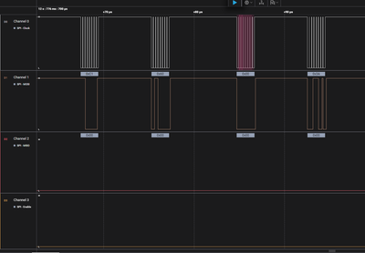

anandhram1988
I always get zero in response from AIS2120 sensor, anyone can help please

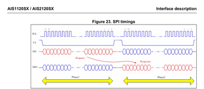

The chip expects 32-bit messages and you're sending 8-bit messages.
anandhram1988
actually i also tried with 32 bit messages, you can see trace below
Show two valid 32-bit transactions back to back as it does in the example, with proper CS line handling.

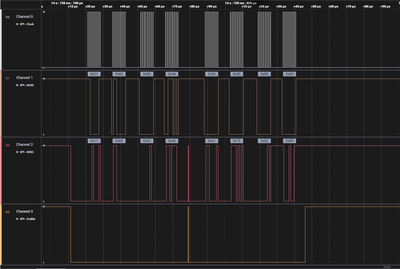

anandhram1988
hi @Andrew Neil  yes, i can see the responses from sensor, now debugging further with this but i dont know why the spi clock must be downscaled its works with <1Mhz as of now
Again, you should look at the signals in the analogue domain with an oscilloscope - are they clean?
Are you still using the logic-level translator? If so, maybe that imposes a limit - the oscilloscope would tell you!
Looks like it's working to me.
Long wires are not going to be amenable to high data rates.
