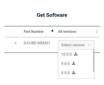

Since the IKS01A2 is not recommanded for new designs, then the examples using this Shield was not included on the new X-CUBE-MEMS1. But you still can download any older version (9.6.0 for example) where you can find examples using that shield:
