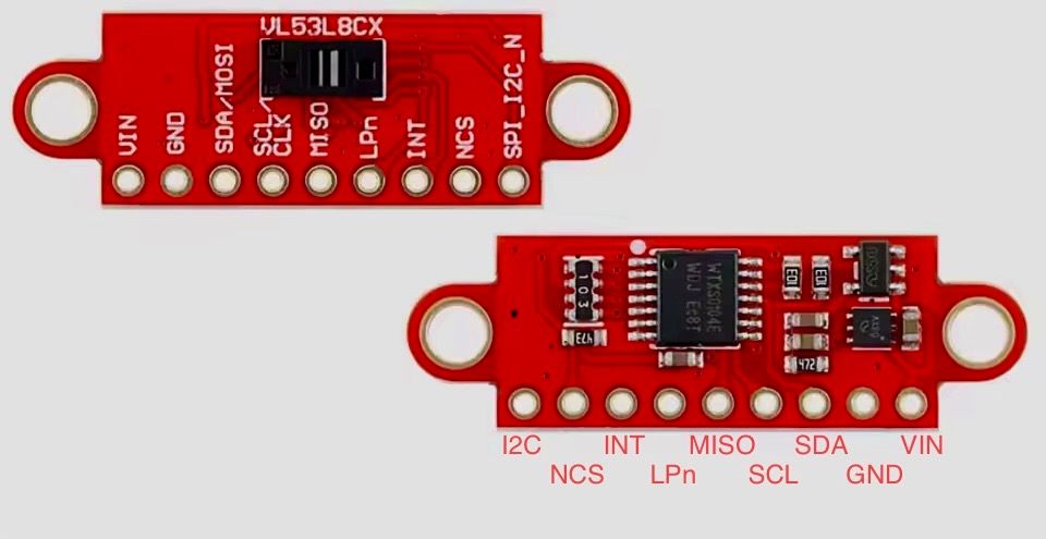

I am using a Chinese VL53L8CX module from AliExpress, not the official ST evaluation board. I want to stress that in the first sentence because this may be important: this is a Chinese AliExpress breakout, not the original ST hardware. The same module works on my setup over I2C, but I am trying to bring it up over SPI on an ESP32-S3 and I am stuck at a very specific point.

I looked into this forum topic more carefully, and it turns out my module uses the wrong level shifter.
This is a Chinese VL53L8CX breakout, and it appears to be populated with an unsuitable translator chip for this application. So the problem is most likely not in my firmware, but in the hardware design of the module itself.
That explains why I could get partial communication but never stable full initialization.

Hi
Glad to hear you have found the root cause. Congratulations~
