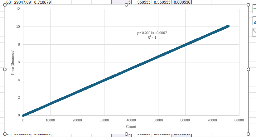

The time is first, the acquisition_json said I had a start time and end time that were 11.03 seconds apart.
The processed log said that I had a 10.3 second record length.  This is a plot of the time output in the record log against the record number.  It has a R squared of 1, that is impossible on electronic data, this is a C++ program output.

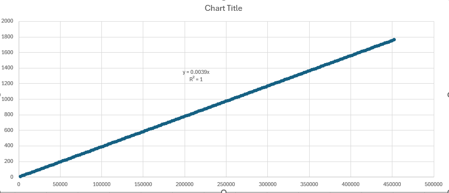

Next is the same plot with the real byte data from the acceleration dat file.  This is an analysis in EXCEL.

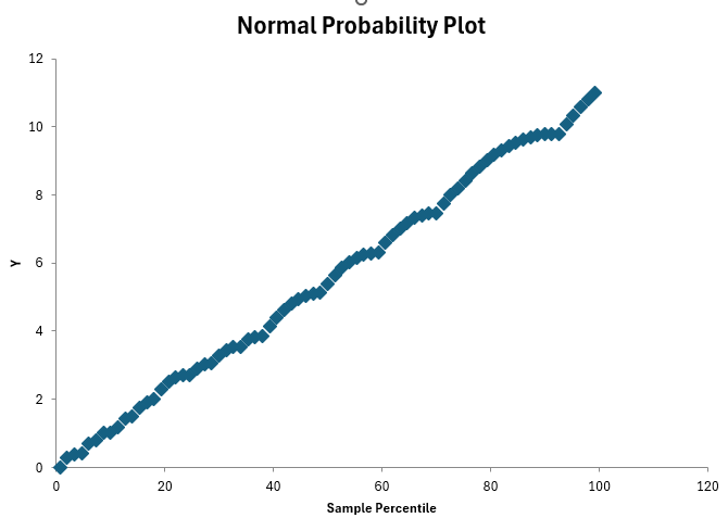

Notice the secondary wave or Fourier series.  If I show the NPP
The NPP shows the Fourier series on the linear regression. It is normal data as expected, there is a minor load but the non-Gaussian element is not of concern.

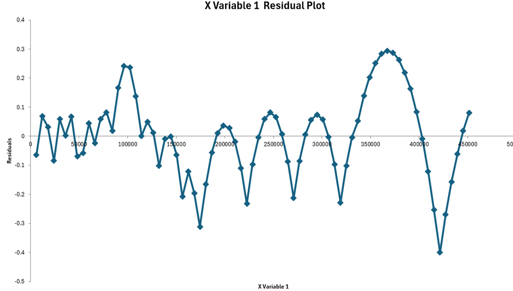

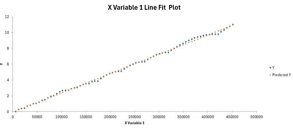

The residual plot shows why your first plot is nice, but it is based on the theory that the records all occur equally spaced, this says otherwise.  I am sorry, but one believes  the data and not the theory.
The linear regression from EXCEL shows the zero is almost a zero but not quite and the slope is so defined the error is close to zero, really close to zero.
 CoefficientsStandard Errort StatP-valueLower 95%Upper 95%
Intercept-0.082480.034077-2.420470.017989-0.1504-0.01457
X Variable 12.44E-051.29E-07188.49857.1E-1002.41E-052.47E-05

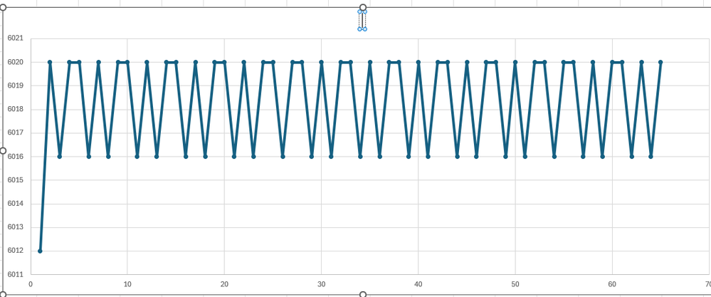

I could set up an array that duplicates the elements of the bytes array from the dat file and mark all of these elements as 1, C# automatically makes it all zeros on allocation.
Then one hunts for the timing signals, the incorrect assumption is that they are equally spaced, they are not.  There is no help in the manuals that is this precise and asking the question elicited the standard answer look in the manual. I did, I have them all printed out and I read them at night.  The manuals vaguely refer to 1000 step, but we have the six and four blocks interspersed that makes the odd set of offset numbers.
One is looking for data in this form - and when you find one you mark it as all 1's.
6012401
6013531
60141991
6015871
6016501
60172471
60182221
6019631
The offset delta to each time number is shown on the graph for the uploaded file, I have as yet not tested it further on more data.  The pattern is not a uniform series and it repeats at 29 steps.  29 is prime so it is a good choice.  The underlying control must be the interaction of the four, the six and eight.  Why not just extend the four to six with two zeros and make the eight two sixes with four extra zeros, then the counting is easy.
I can now mark with 1's all of the data. One finds this by looking for the constant bytes in the timing data.  In this case the eight byte that is 63 or 64.
So now we have a array with zeros and 1's and 2's so we should just step through the array and take out the sub array that has all values equal to zero.

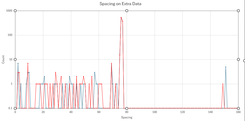

Smithson
Data files for analysis
I had to do it as three posts as it threw a fit at one.
i have now done the second data file. The blue is the spacing on the first file for the extras and the red for the second file.  The 78 and 79 match exactly on the count, this is statistically unlikely.
Also your temperature calibration on the device is in error, the device is kept in a room at 20C, the second source of error may be device heating, one has to assume that that was considered in design.  Your device reads a nice 30 C.  The room is never at 30.
The frequency response of a building can have significant temperature impact that we need to allow for using multiple linear regression, any advice on the reason would be appreciated.
So we mainly work with bridges and buildings, ie structural reliability.

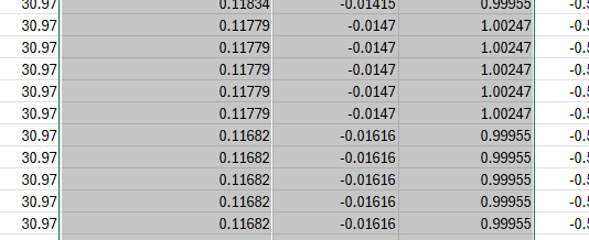

So I have been running the Sensor TIle Box Pro at about 1800 Hz,  and instead of getting a duplicate every 76th row I get 4 duplicates from MEMS STUDIO analysis on all runs.  Sample shown.
One would hope that ST.COM people would say something like thanks for telling us about the error and we will fix it.
Of course, silence works as well.

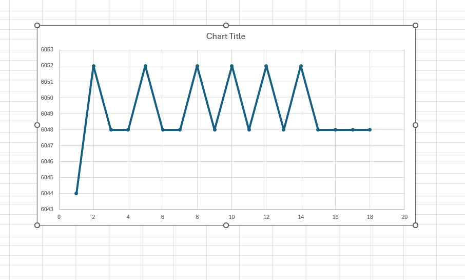

This is almost the step function for the timing, I made a mistake at 17 it should be 6052, I have fixed it but too lazy to get a new snap.
I have not found the repeat yet as I only go to 18000 records.
I have not worked out how to set the elapsed time to 9.1 seconds.  MEMS Studio does not report the run time correctly.
louda.marian
Hello John,
Format of the .dat file used by Datalog2 firmware is described in the UM3203 which you can find on “FP-SNS-DATALOG2 | Product - STMicroelectronics” web page.
Datalog2 stores data in the individual .dat files for each sensor. MEMS Studio is able to convert .dat files into one .csv file. Each sensor can run a different output data rate. To indicate new data in each row “data_changed” bit field is used. It is described in MEMS Studio user manual UM3233 which you can find on https://www.st.com/en/development-tools/mems-studio.html web page.
It seems you didn't take into account this aspect and this is the reason why you report it as duplicate samples.
Data from device are send in chunks and incomplete chunks at the end are not involved in analysis. This could cause discrepancy between metadata and MEMS Studio record time.
Best Regards,
Marian
Dear Marian:
I am not reporting duplicate entries on my software written in C#, I am reporting duplicate entries in the MEMS Studio CSV file.  You have a duplicate entry in at 7600 recording cycles of 1 every 76 entries.
1. I count the number of bytes, your CSV file has excess byte count.  By a long way.
2. I found the duplicate entries and showed them in an earlier post.
My software is correct.  I have an exact count of bytes to output at 1 to 1 and no duplicate entries.  MEMS Studio in 1860 Hz recording does 4 copies per step of the acceleration data.  You can see it in the post.  This is not my software this is your software.
As a check I use hex editor to check all of the lines.
I am not wrong, I do this all the time.   I am happy my software is correct, I am sorry but your software has a bug.
I am happy to zoom to show you.
This is only the accelerometer, I have not found errors with Pressure or temperature and I am not looking at GYRO.
John
